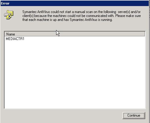

Since I installed ISA 2004 and SP1 on SBS 2003 my Symantec Antivirus 9 doesn't seem to work on my client computers. Any word on this? Workarounds, patches, etc?

Thanks for the reply. Well, first on my client computers XP started saying it couldn't find any virus protection. Then on my server when I open up the Symantec System Center Consol and try to start a manual scan on a client computer it says, "Symantec AntiVirus could not start a manual scan on the following server(s) and/or client(s) because the machines could not be communicated with. Please make sure that each machine is up and has Symantec AntiVirus is running." (Interesting grammar [Smile] )

On the client machine there is the antivirus app that runs basically standalone, but it is configured via a console on the antivirus server.
This server can be installed on any computer, but usually in SBSland it gets installed on the SBS/ISA server. The AV server pushes updates and configuration info to the client and this fucntion see to work ok. In the console you can also select a wks or wks's and then select start manual scan, this is the fucntion that is being blocked.
Here is the error

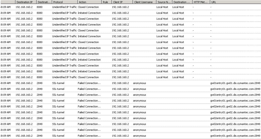

Not ignoring you Dr. Tom, when I try to get the realtime monitoring it runs for a few seconds and then says too much data.
I am tryign to track down where the local to local traffic is coming from. Bizillions of entires

Yes it is driving me nuts.
Here about 2 seconds of activity
And this is the 2 errors that fill the monitor
Original Client IP Client Agent Authenticated Client Service Server Name Referring Server Destination Host Name Transport MIME Type Object Source Source Proxy Destination Proxy Bidirectional Client Host Name Filter Information Network Interface Raw IP Header Raw Payload Source Port Processing Time Bytes Sent Bytes Received Result Code HTTP Status Code Cache Information Error Information Log Record Type Log Time Destination IP Destination Port Protocol Action Rule Client IP Client Username Source Network Destination Network HTTP Method URL
0.0.0.0 SignatureImporterThread: No Proxy SBS2K3P gw01entry01.gw01.dis.symantec.com TCP Internet - - - - - - 0 0 1138 0 12204 The specified Secure Sockets Layer (SSL) port is not allowed. ISA Server is not configured to allow SSL requests from this port. Most Web browsers use port 443 for SSL requests. 0x0 0x0 Web Proxy Filter 8/5/2005 8:54:55 AM 192.168.160.2 2848 SSL-tunnel Failed Connection Attempt 192.168.160.2 anonymous gw01entry01.gw01.dis.symantec.com:2848
192.168.160.2 SBS2K3P - TCP - Yes - 60713 0 0 0 0x0 0x0 0x0 Firewall 8/5/2005 8:54:55 AM 192.168.160.2 8080 Unidentified IP Traffic Initiated Connection 192.168.160.2 Local Host Local Host - -
Any ideas?

Hi Andy,
Wowza! [Smile]
There are pretty interesting entries [Big Grin]
One thing clear here is that you need to extend your SSL tunnel port range. It looks like the Symantec site requires TCP 2848 for the SSL connection. There's complete explanation in the book on how to extend the SSL tunnel port range.
This might fix the other problems too.

Well I found an article by one of my favorite authors, that explained the problem and pointed to a couple of tools to use to resolve it. I used the gui tool which worked like a charm and you were right it also solved the other problem. I thought I would share that article with everyone here Extending SSL Port Range Article not that I don't want to get a hold of your new book, I just was not wanting to have to wait for delivery to solve my problem :>)
